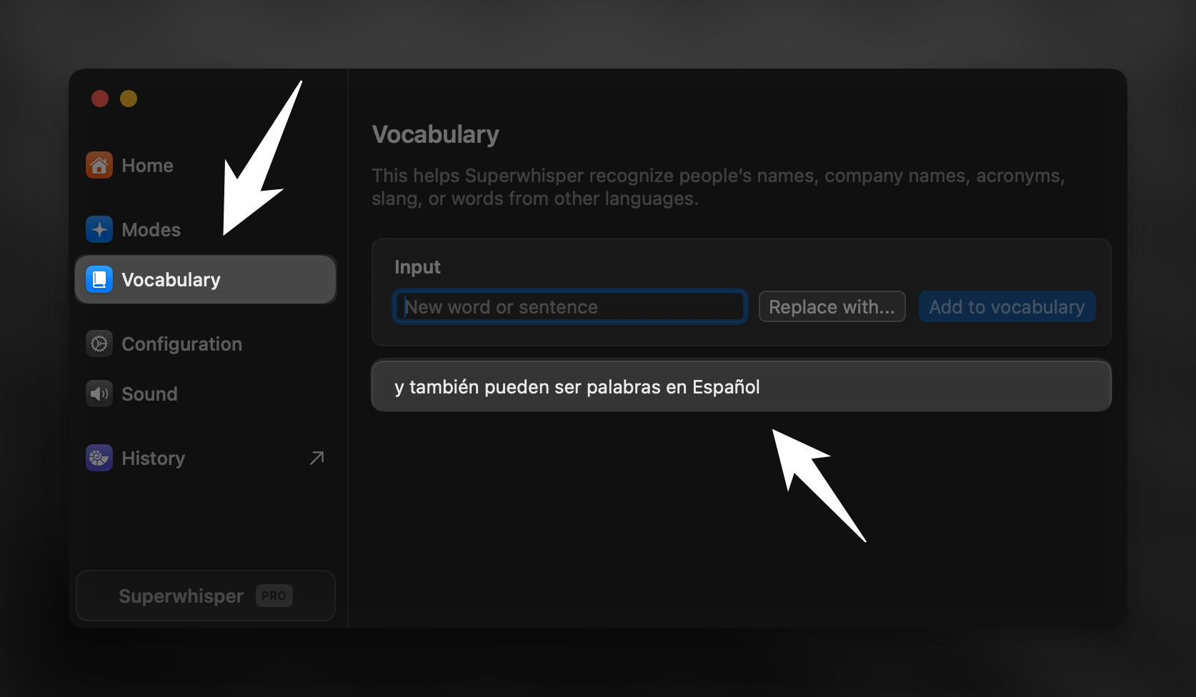

Solution: The Vocabulary Hint
You can significantly improve automatic language detection by adding a simple phrase to your Vocabulary list:
Open Vocabulary Settings
Navigate to the Vocabulary tab in SuperWhisper settings.
Add Phrase in Your Language
Add the phrase “and it can also include words in [LANGUAGE]” written in your target language. For example, if you speak Spanish, add: “y también puede incluir palabras en español”.
Additional Considerations
For best results, add a few more individual words to your vocabulary and keep the list short for optimal performance.
Model Compatibility
The vocabulary hint works effectively with all voice models except Nova or Parakeet. Nova and Parakeet models don’t support multiple languages within the same dictation session. You can still add the vocabulary phrase without negative effects, but you won’t get the multi-language benefits.
With models that support the vocabulary hint, you’ll get much better language recognition. You can also switch between multiple languages in a single session without having to adjust any settings.
