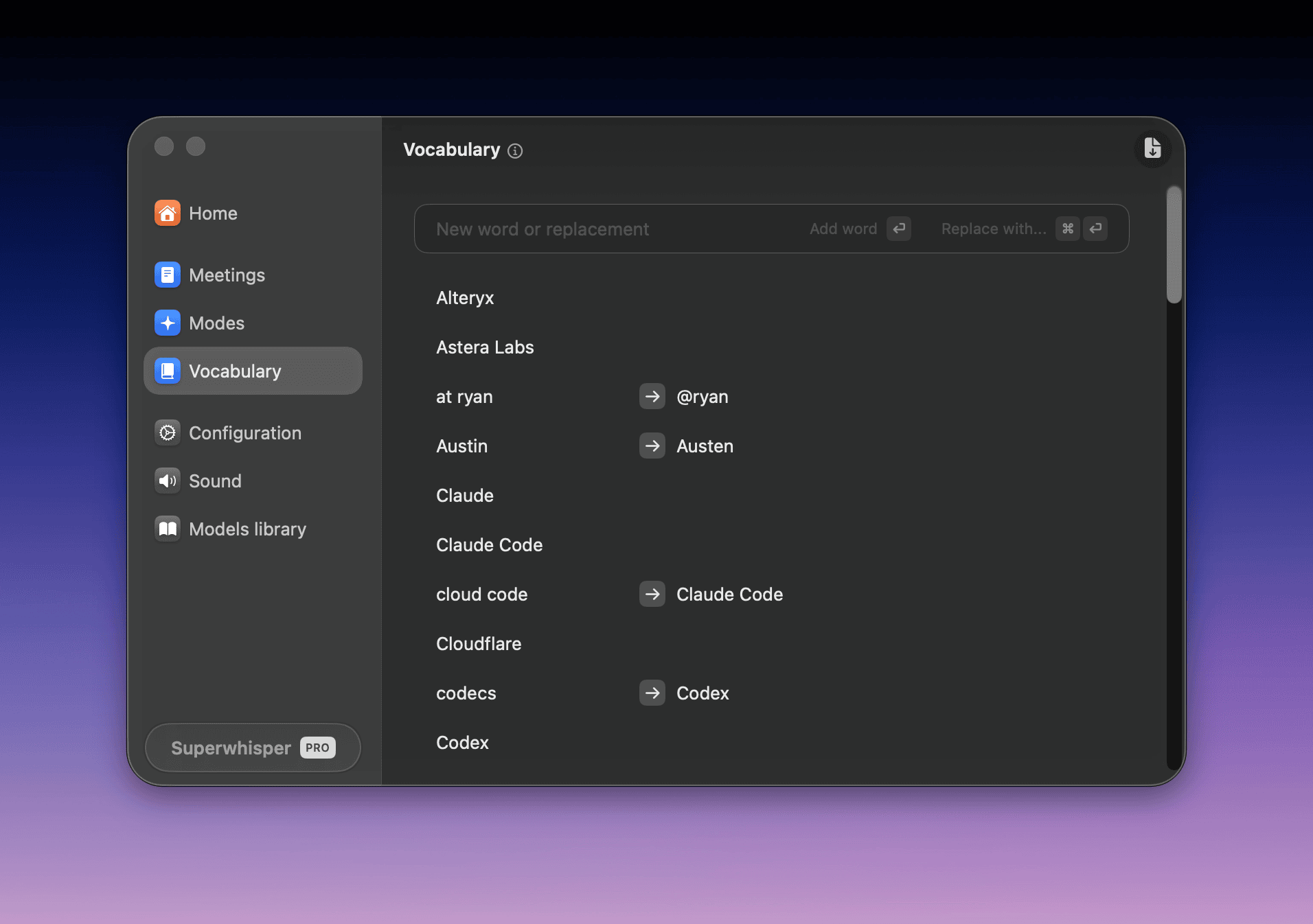

How replacements work
Replacements run after transcription. Once your dictation becomes text, your configured replacements are applied programmatically, with no AI interpretation, so they happen exactly as you define them.
Replacements match words regardless of capitalization. The matching system is case-insensitive, so “todo” will match “ToDo”, “TODO”, or “Todo”. The replaced output will appear in the exact case you have specified for the replacement.
When to use replacements
Use replacements to correct persistent errors or expand frequently used phrases. Because they run independently of AI, the results are consistent and immediate, no matter which model transcribed the text.
If a word is consistently mis-transcribed several ways, add a replacement for each variation and point them all at the correct result.

Voice models are tuned for natural speech, so symbols like @, ., /, and # rarely come out the way you’d type them. Replacements fix this: dictate a phrase, and it converts to the symbol you want. Add each one as a replacement (see Managing the list):
Dictating email addresses
Add your most-used email addresses as replacements. For example: For one-off email addresses, dictate them as name at sign domain dot com and rely on the symbol replacements above. For unusual names the model won’t recognize, add the full address as its own replacement instead.

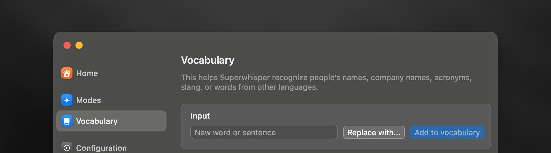

Vocabulary words and replacements share one list in Settings → Vocabulary. Type in the New word or replacement field at the top, then:
  • Add a word: press Return (Add word)
  • Add a replacement: press ⌘ Return (Replace with…) to open a second field. Type the text it should become, then press ⌘ Return again (Add replacement)
To remove an item, click the × next to it. To add many words at once, click Import CSV at the top of the page. You can also manage both from the terminal with the Superwhisper CLI: superwhisper vocab for vocabulary and superwhisper snippets for replacements.
