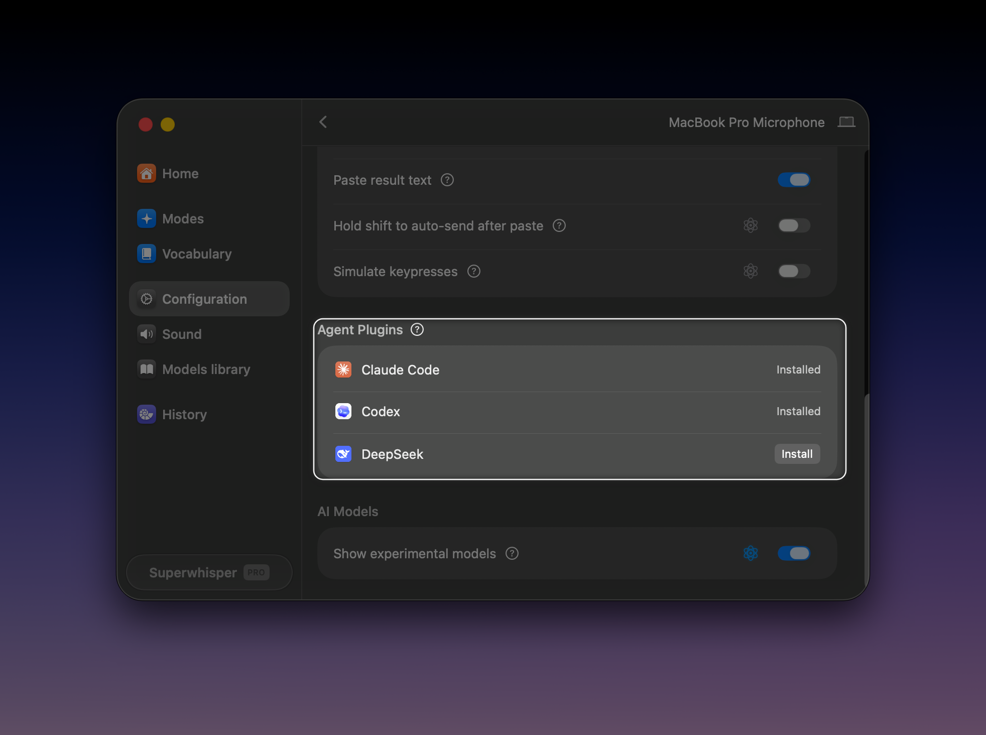

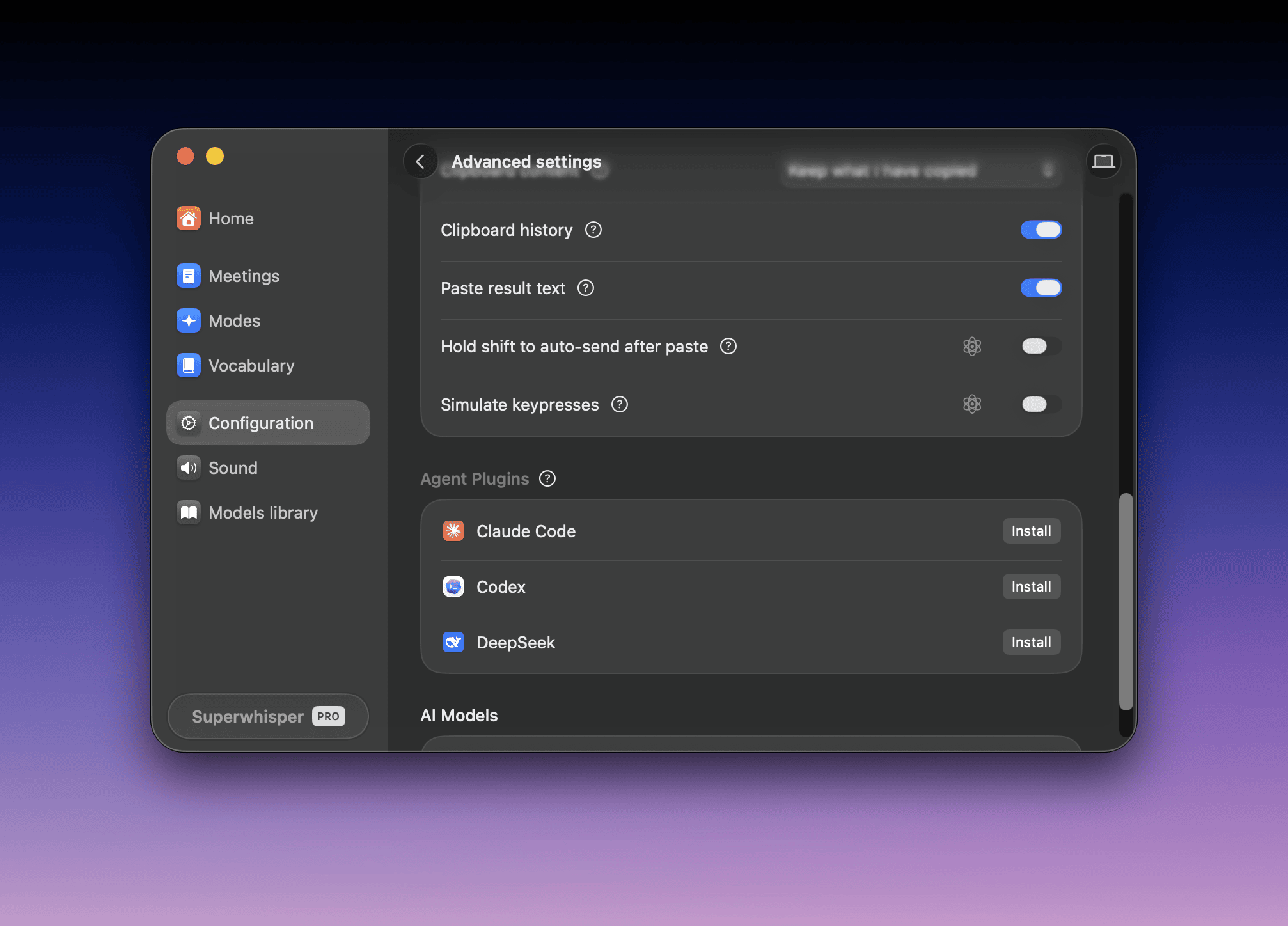

Open Settings → Configuration, click Advanced settings at the bottom, and scroll to Agent Plugins. Superwhisper detects the supported agents installed on your Mac; click Install next to an agent to connect it. The connection is live the next time you start that agent. Superwhisper Advanced settings showing the Agent Plugins section with install buttons per agent Superwhisper installs a small plugin into each agent’s own configuration.

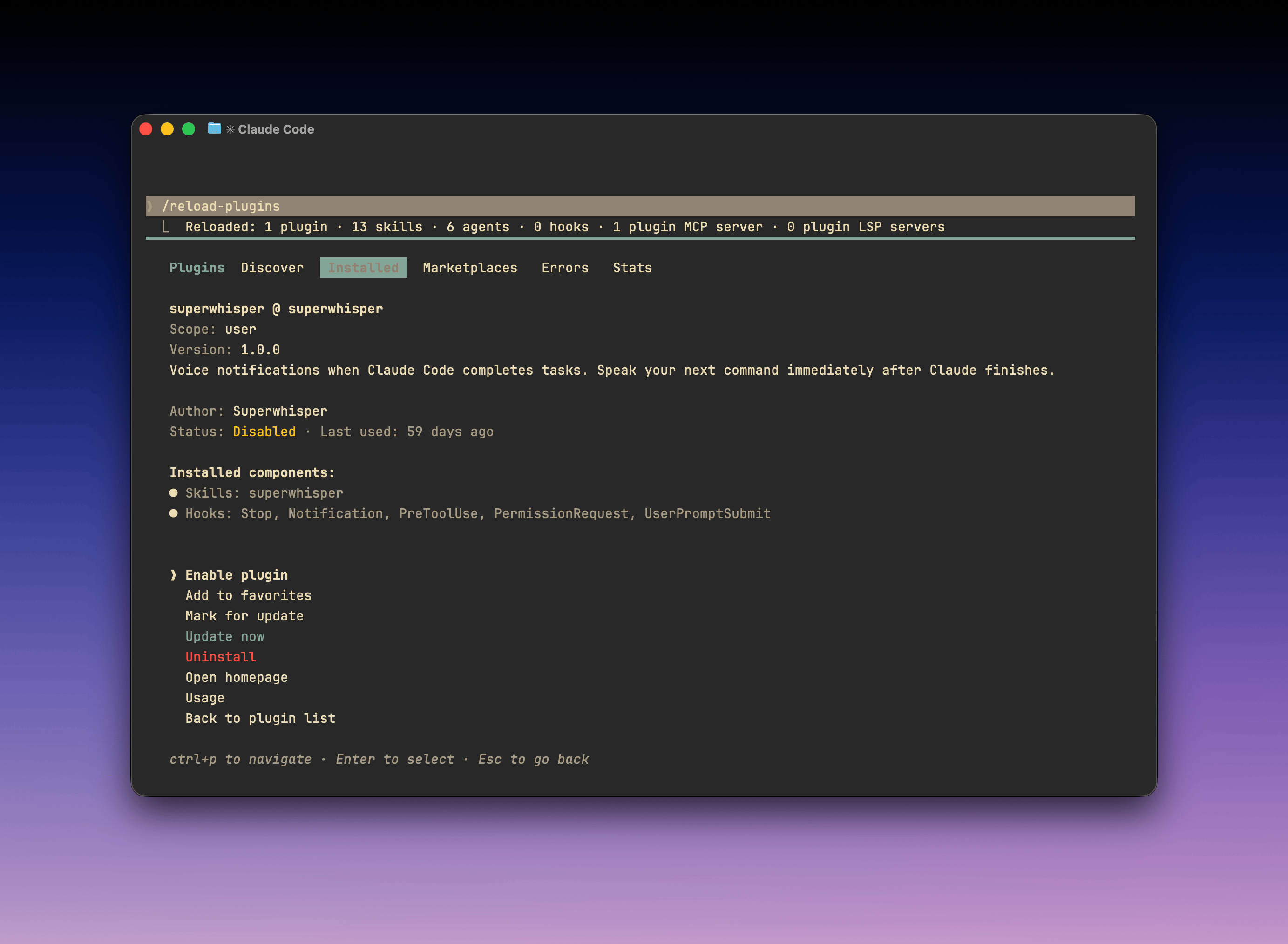

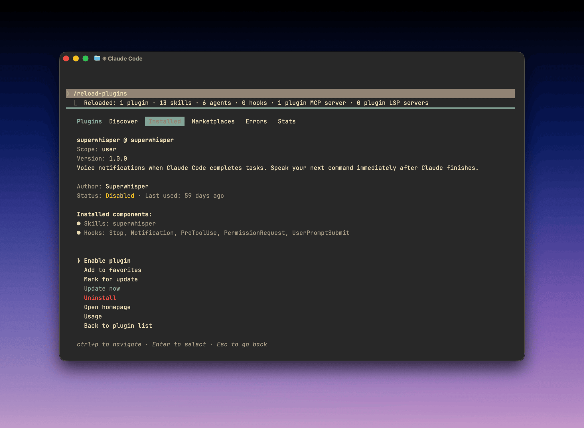

  • Claude Code: run /plugin inside Claude Code to enable, disable, or uninstall the plugin. It’s listed as superwhisper@superwhisper. Claude Code plugin manager showing the superwhisper plugin with enable, update, and uninstall options
