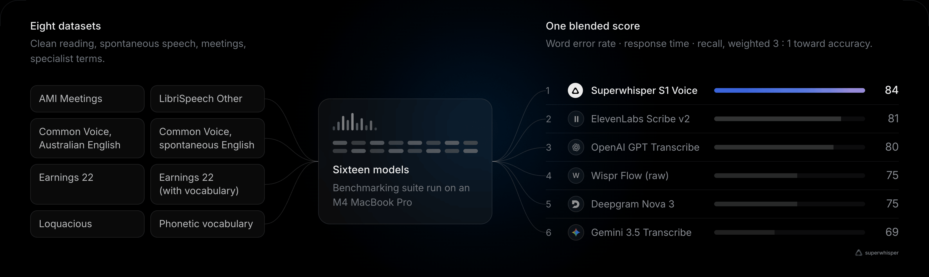

Benchmark method: eight datasets, sixteen models, ranked by blended score Every measured figure in these docs, meaning word error rates and response times, comes from one benchmark suite: 16 speech models over 8 datasets, our own models and the ones we compete with, on the same audio and the same machines. The full leaderboard, with a page per model, is at superwhisper.com/benchmarks. The Speed and Accuracy columns in the model tables are a different thing: hand-assigned 1-to-10 ratings for comparing models at a glance. What the model tables show explains why both exist. This page covers how the measured numbers are produced, so you can judge whether they answer your question.

How the blended score works
The leaderboard’s headline score puts accuracy and response time into one number out of 100, weighted three to one in favour of accuracy. A transcript you have to correct is not a fast transcript. Recall and F-score are reported alongside it but don’t feed into the score. Both ends of the scale are fixed values rather than a ranking against the field:
  • Accuracy scores zero at a 30% word error rate. At roughly one word in three wrong, a transcript is faster to retype than to fix.
  • Response time scores full marks under one second, because you cannot beat instant, and zero at eight seconds.
Because the anchors are fixed, a model’s score doesn’t move when another model joins or leaves the benchmark. Cloud and local models are ranked separately. A hosted model and one running on your laptop are answering different questions, and a combined ranking would mostly measure which of the two you happened to pick.
Datasets
Eight sets, chosen to cover clean reading, spontaneous speech, meetings, and the specialist terms custom vocabulary is meant to catch. Each dataset counts once regardless of how many clips it holds, so a large easy corpus can’t paper over a small hard one.

The leaderboard publishes the rows where somebody else comes out ahead, because a benchmark that only shows your wins isn’t a benchmark. As of the September 2026 run, S1-Voice leads on blended score and word error rate, while ElevenLabs Scribe v2 and OpenAI GPT Transcribe lead on vocabulary recall and F-score.
