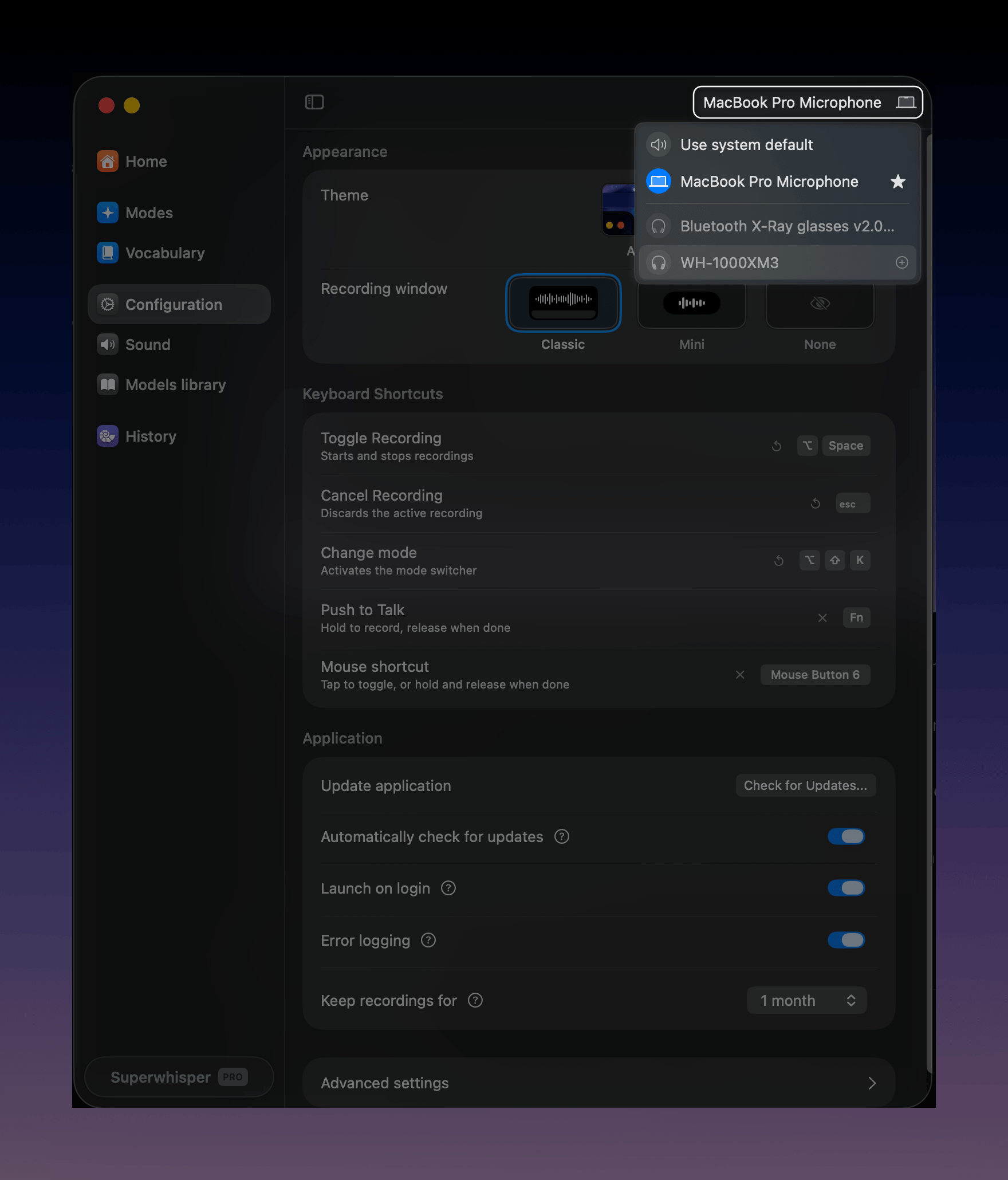

Check which microphone is active
Click the microphone button at the top right of the Home, Configuration, or Sound page to see the active input device. If it’s the wrong one, such as a disconnected headset or a muted external microphone, switch it or choose Use system default.Superwhisper input device selector open from the top-right of the settings window
